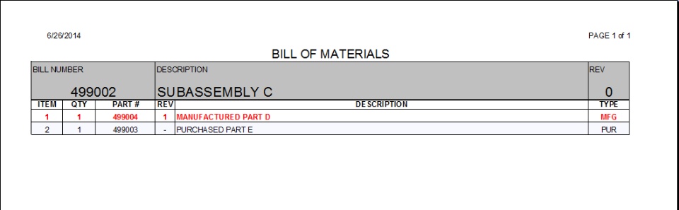

I have created an EPDM add-in to allow users to right click on an assembly file (or a drawing or PDF of an assembly) to display a 'Print BOM' menu item.  The addin will open Excel and create a nicely formatted BOM for printing like this:
Because we do not have a formal ECO/ECN process, it is not uncommon for a part drawing to be revised without updating the assemblies where it is used.  To highlight such items they are displayed in bold red text as shown above.
Internally, the add-in is retrieving the BOM from the SolidWorks drawing (using GetDerivedBOM).  This BOM may be out of date if any of its components have been revised so I call GetComputedBOM and replace any out of date info. Any such replacements are flagged so that I can highlight them in the Excel output.
