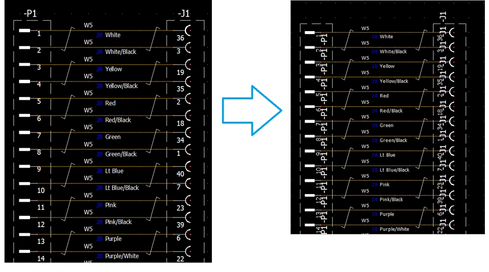

Hi, I'm just curious if anyone else experiences this issue with attribute text randomly going back to default orientation/position? For example, below you can see a bunch of connector pin symbols. On the left is an image of how I ultimately re-positioned the attribute text of the pins. On the right is the attribute text scrambled back to (what I assume is) their default positions/rotations.
I think I've seen this happen with all types of schematic symbols, but it seems to happen most with connector pins and wire labels (probably because I manually reposition attribute text with those the most). I'm not sure the trigger(s) for this happening, but I get a sense it happens more when I leave the computer for a while (computer goes to sleep) and my network connection to the SQL server drops. But I don't think that is a hard rule.
Has anyone else experienced this and is there a way to prevent it from happening?

CM 2026-02-26 Best Answer
Nick, Yes the Network drop is the root cause of your problem. I would recommend that when you are going to leave you computer for a while where it will go to sleep I highly recommend that you close the application, I am surprised that you do not get any Locked pages(drawing) errors as the collaborative server also drops the connections. I also recommend that all Energy saving options be turned off for your network cards, this can also cause problems.
NS
NS 2026-02-25
Recollecting prior instances of this happening, it might also be related to opened/active sheets. Maybe active sheet + dropped server connection = reverting to original position/orientation of text attributes? The "fix" might be to close the sheet to "save" the new text locations/orientations.
