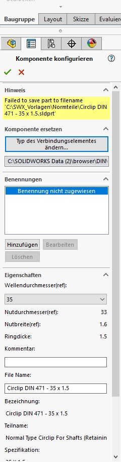

I get always a error message. "Failed to save part to filename
'C:\\SWX_Vorlagen\\Normteile\\Circlip DIN 471 - 35 x 1.5.sldprt' (the last is the partname)
I must copy the toolboxpart from a othere PC and paste it into my "Normteile" folder, then I can use it.

AK 2021-04-09 Best Answer
Marco,
As far as I know toolbox keeps the files read only.
You are not supposed to directly edit the parts. The correct way (to assign PNs, Descriptions...) is through its configuration utility.
if you insist on saving the part then in windows explorer navigate to the file and remove the read only flag (provided that you have sufficient privileges).
