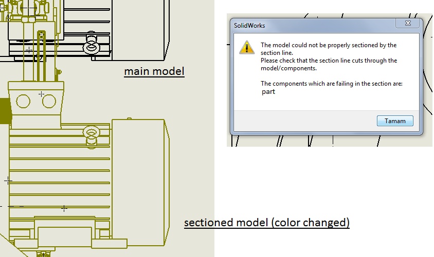

solidworks can not cut the imported part in assembly drawing (or  assembly environment). therefore I cant make a section view correctly. how can I solve this problem?

Try moving your section plane slightly.  If shifting the plane works, then you probably have a Zero Thickness problem when the plane is in the original location.

In order to be sectioned, an assembly component must be a valid Solid.  Imported data-even if it's solidified sometimes has topology errors that make it a pain to work with-especially if the program it was imported from is Pro-E.
run import diagnostics on the imported part:
Open the part,
go to the Imported feature in the feature manager tree and right-click.
On the context menu that appears, select "Import Diagnostics".
You should read the help on Import Dignostics before attempting to repair the model.

Try stretching your section line to extend past the boundaries of the assembly.

Can you post a screenshot of the view  that shows the section line?

Can you extend the length of the Section B line so that it is the same length as the Section C line?
Your section line needs to extend past the limits of the model, and it looks like there is a portion below the Section C line that stick out beyond the end of the Section B line.

Ozkan, calling this a bug is premature.  The indications are the SolidWorks cannot section your model either because your section line doesn't extend out past the model's bounding box (edit the sketch for the section line and drag the point farther to the right.  Alternatively, go into the section view property manager and check the 'partial section' checkbox).  I know it looks like your section line is long enough, but if you have hidden solid bodies in your parts, those could cause the sectioning tool to error out.
Another possibility is that there's a problem with the model that prevents it from sectioning.
Another possibility is that the position of the section line places it tangent to a face, or otherwise creats a region with no area.  In this case, add a jog to the section line to avoid the tangency.
I'm not saying that there aren't bugs in the sectioniong tool, but there's a difference between a bug and an error condition and your screen shot and problem description seem to indicate this issue particular to this one model view.

I do not understand. it must be possible shorrt section line for the section view. so it isnt solution extend to line. I tried the same application with inventor. inventor sectioned correctly.
