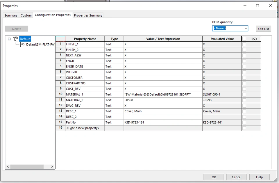

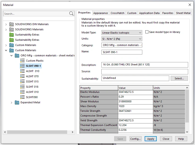

I'm currently working on a project in SolidWorks 2024 and attempting to access and copy material sub-properties, such as Description and Source, from the material properties tab to the File|Properties tab using VBA. Despite various attempts, I've encountered persistent difficulties.
Here's a brief overview of the steps I've followed:

Despite various modifications, I keep encountering runtime errors, such as "Argument not optional" and difficulties in retrieving the material sub-properties.
Could you please provide guidance or correct the code to successfully access and copy the material sub-properties (Description, Source) to the custom properties tab?
Thank you very much for your assistance.
Nelson
from here...
to here...
