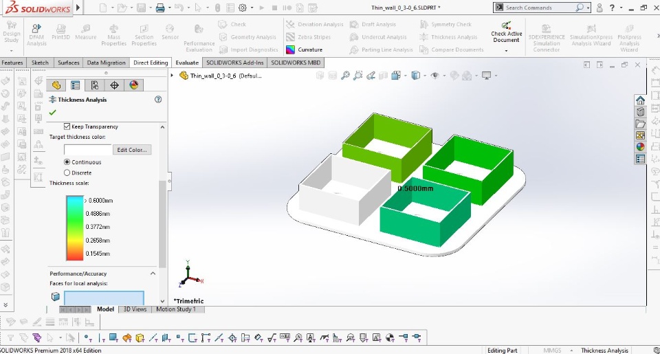

I use the above code that run thickness analysis in a part and it works well. The only problem is I can't let it just stay at the analysis view, it will automatically closed even the following code:
' Close the thickness analysis tool
lStatus = utThicknessAnalysis.Close()
' Release
Set utThicknessAnalysis = Nothing
Set utAddIn = Nothing
' Done
Exit Sub
Any idea how I can stop the analysis from closing? I want to use a userform button to control the analysis to be just on or close. The image indicate what I means for analysis ( I want this page to just stay until I manually close it)
