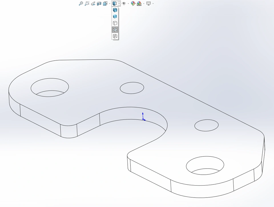

Solidworks 2025 sp2.0. Hidden lines are not displayed in hidden line visible mode. Who knows why?

@MM try to disable this enhanced performance option, reopen SW and test

What happens if you use the last one...? Do the lines appear?

Close all documents. Go to System Options...Performance and enable the 'Use Software OpenGL' option. Open your file and see if the problem is gone. If so, you have a graphics driver issue.

Can you upload the file?

If you move the mouse over where the hidden lines should be do they highlight? Like this:

'View > Display > Draft Quality HLR/HLV' needs to be turned on, somewhat surprisingly. Could you try this?

Tested your uploaded part. On our system, running SW2025 SP2.0, selected "Hidden Lines Visible", the lines are not shown but selectable. Updating the part template, makes the part act normal. Template is really old, so try with new part templates.

It is always a great idea to open you template and review they system settings available and the document properties on each upgrade. It avoids many problems if you pick the right settings.
