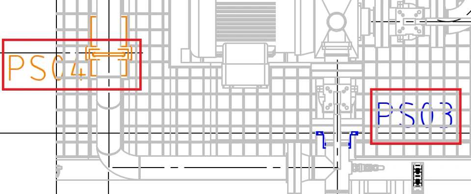

I am currently doing a drawing in SW2020. I have some notes that I want to bring to the front but cannot figure out how to do it.

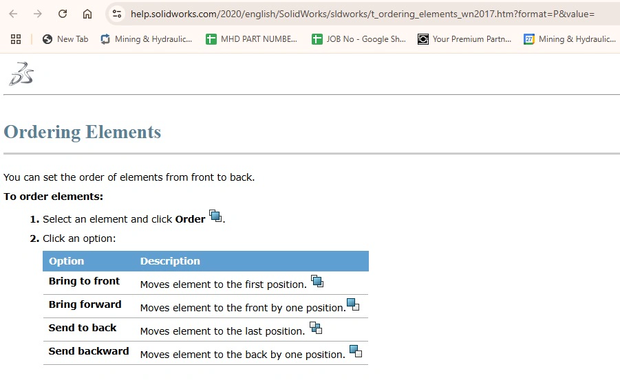

After a Google search there seems to be a solution by selecting the note and clicking on "Order", although I cannot find this Order option. I've tried searching for it in the SW search bar but cannot find anything.

There's not much Z-order control in SW, but you can set a note as a watermark.

I created a block to do some masking that is not available in notes.  you may want to research this.  I googled how to do it and cant remember the steps.  maybe this will help.

SW masking, "halo", is only within hatching.
