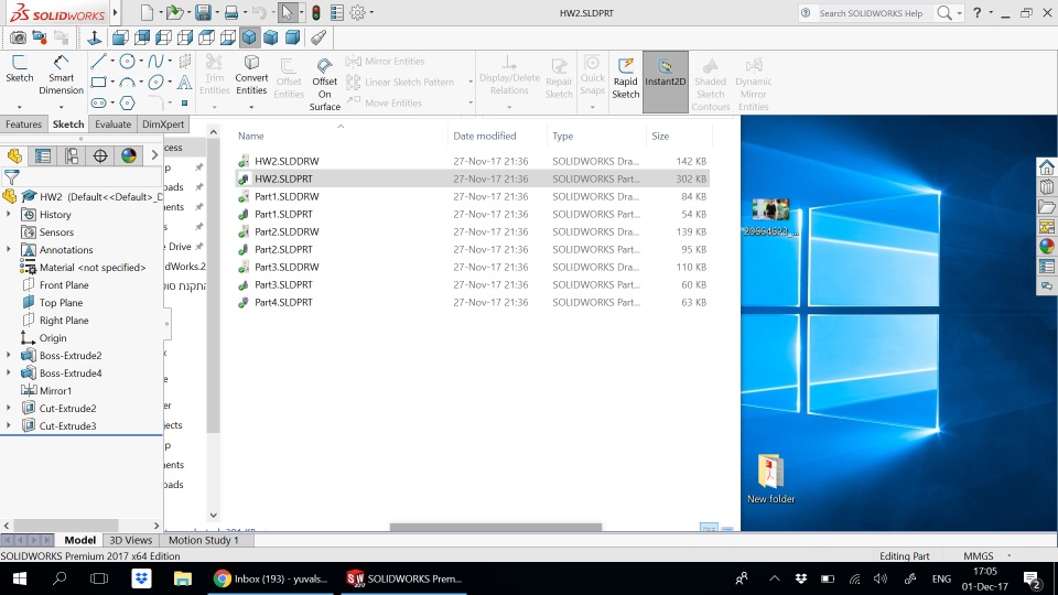

I recently installed SolidWorks 2017 on my laptop.
The program doesn't function at all - I can't see the interface / planes and start drawingparts, the work area shows the initial SolidWorks logo.
Moreover - if I minimize the program and maximize it, it partly shows my desktop...
Screenshot attached.
Any idea?

Going to need a LOT more information:
What Version of Windows are you using?
How much RAM do you have?
What SP of SW 2017?
Have you checked the minimum requirements for Solidworks?
     SOLIDWORKS | Hardware & System Requirements | SOLIDWORKS
What Graphics card are you using?
Have you verified that the version of the driver for your graphics card is the latest approved and tested version?
     Graphics Card Drivers | Hardware & System Requirements | SOLIDWORKS
There are probably more questions.....but start there.

Thanks for your quick response.
Using Windows 10 Home
8 GB RAM
SP1
Nvidia GeForce 940MX 4GB GDDR5
Basically I just recently bought a brand new computer in order to use SolidWorks Properly..

I believe that the issue is your GeForce Graphics card.
Read these:
YS
YS 2017-12-01
Looks like your belief is correct...
I have read about it in those links.
The "Open GL Mode" fairly works - the performance is pretty low, but at least it somehow works.
What is this mode means exactly? And, is there a chance that any driver installation could gain a better results?

This option disables graphics adapter hardware acceleration and enables graphics rendering using only software. And when this option is on. some of the settings are changed for optimum software performance.

Are you using Windows Aero theme? If not then switch to Aero theme and check again.

Aero Theme is not a SOLIDWORKS settings but window's settings

Of course. I looked in Windows settings, but I'm using Windows 10 (Your screenshot is from Windows 7, am I correct?)
DG
DG 2017-12-13
<p>Yuval Shayovitz wrote:</p><p></p><p><span style="font-family: inherit;">Your screenshot is from Windows 7, am I correct?</span></p>
Yes that's correct.
Check solution suggested by here
