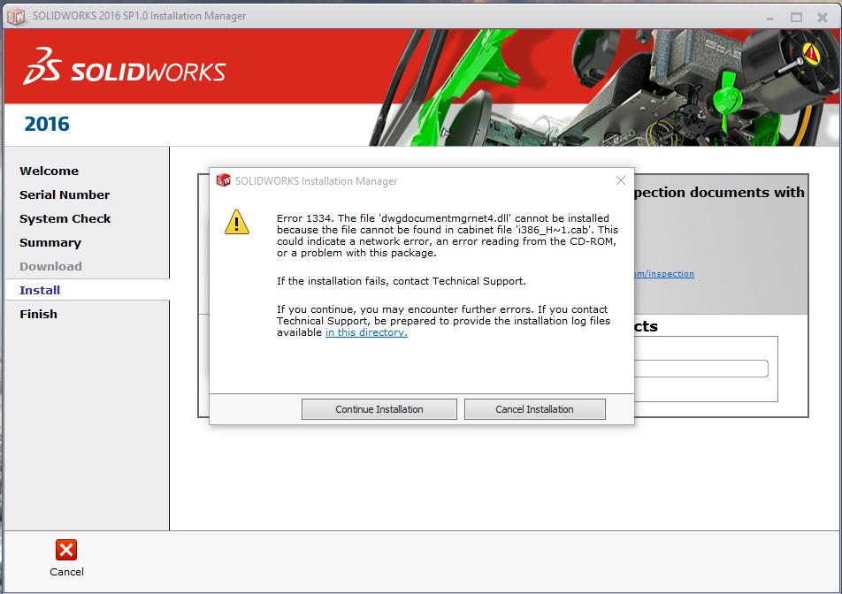

I've tried to install the Solidworks 2016 service pack v1.0 upgrade today. The files downloaded fine, however at about 33% into the installation I got the following error:
I have attached the installation log files to this discussion.

Hello Ben,
My advice would be to start the setup again and choose 'Download Only;
This will download everything.
Run the setup again and you should not have any missing files.

Hi Francesco,
Thanks for your answer, it didn't work when I chose 'Download Only' as it said that the files had already been downloaded - however the problem was solved by choosing the 'Download and Install' option next to 'Download Only'.

I had a similar problem when I installed SW2015 last year.
That turned out to be the Microsoft file "Microsoft.NET Framework 4.5" file that was older than SW wanted.
But the installer saw the file name was there and considered it to be valid and up to date - but then the software install crashed (at 33%).
The solution was to uninstall the "Microsoft.NET Framework 4.5" file and let SW install it from the download.
Since yours is now working it probably was not this - or it could have been that the full download contained the needed file and the install completed correctly.  If you do just the install without the download it apparently can fail to install a needed file.
I always do a full individual download of each release and each service pack and then install from that.
Then I know I have all the files and it installs faster.
