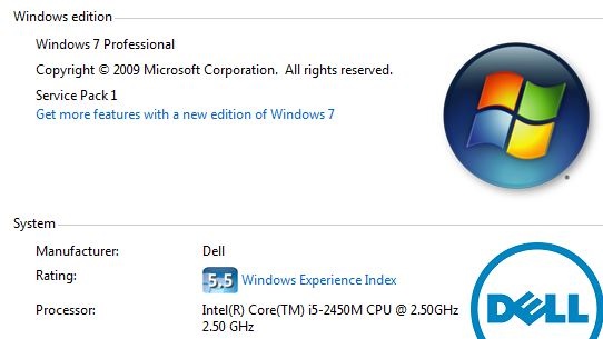

Hi everyone,
I need some help in installing SolidWorks 2014 SP0.0.
I tried to install SW2014 in my windows 7 laptop and the installation manager showed that my laptop is Win7 SP0; SW2014 can be installed only in Win7 SP1. So I updated my system to Win7 SP1. But still the same error occurs saying that I cannot install SW2014 in Win7 SP0.
I am attaching the images of the error and my laptop config.
Kindly help me.

DM 2013-12-25 Best Answer
Dear Ansari ,
you may probably not updated sp 1 of windows --properly.
please do the same process again & then install solidworks.

Thanks for the reply Dayamoy,
I have checked it several times and system is up-to-date.
I have got a reply that to make it work properly, Right Click SW setup> properties> Compatibility tab> make it to run for windows 7.
Thameem

Thank you Rukshan,
I tried the windows update that is actullay recommended.
Finally the problem sorted out,
I tried this, right click the sw setup> properties> compatability tab> Check in the 'run this prog' and give it windows 7.
And now if you try to install, it will tell u that it is Win7 Sp0. Again go to the compatability tab and uncheck the run this prog, then try to install.
This is how it worked for me.

I had a similar issue a few weeks ago.  SP1 was installed through Windows Update but the installation manager barked at me and said I was on SP0.
I went to Microsoft and downloaded the offline Windows 7 SP1, installed and it fixed the issue.
