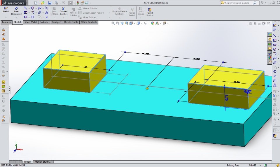

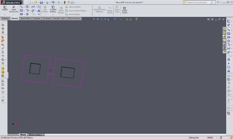

I am using SW2014 to re-construct side plate sections of a vintage recording console, I have drawn out the sections, and I have tried to use a custom form tool to produce the relevant half shears used to mate with the respective ISEP rail profile.
But, every time I use the form tool, the stopped face punch side is correct, but the 'extruded' section is deformed incorrectly.

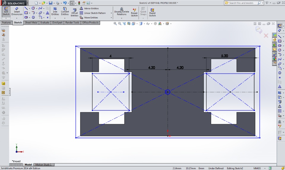

Pic of ISEP profile with punch construction dimensions.
Punch Tool.

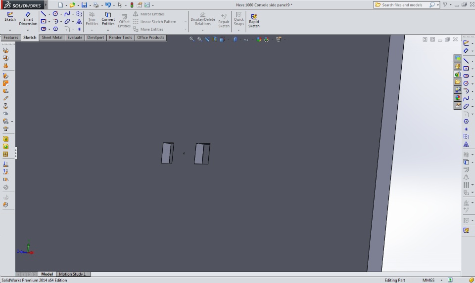

Punched panel with correct indentation (face side).

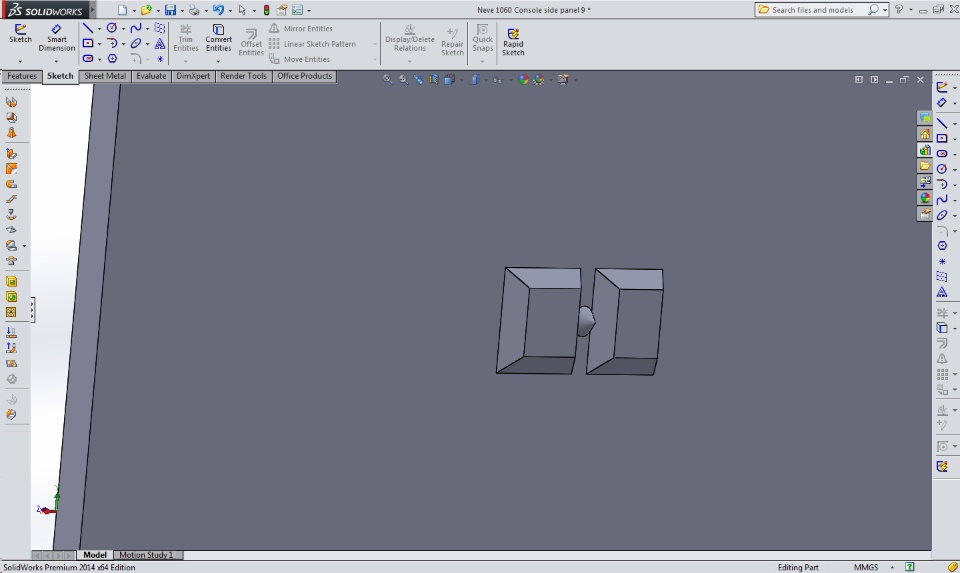

Punched panel from extruded side ( deformed Half Shears).
Punched panel showing indentation marks, with distorted outlines (extruded side).

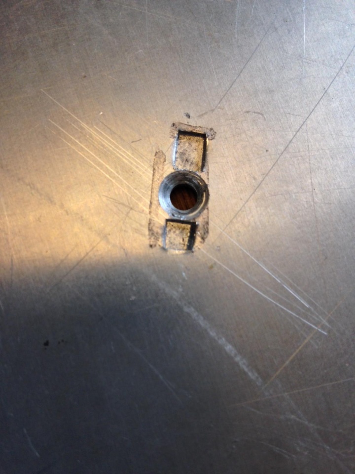

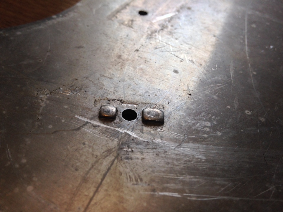

Actual Half Shear - punch side.

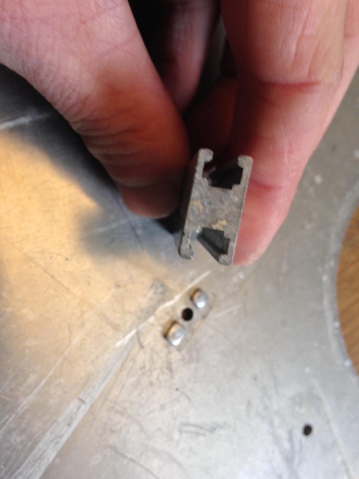

Actual Half Shear - Extruded side.

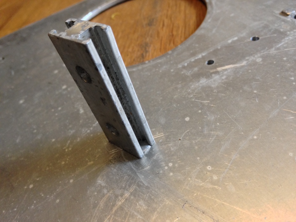

ISEP Profile.
ISEP Profile mating with Extruded Half Shear.

Try making the sides of the squares cutting faces.

Not sure here but it seems that you have extruded the half shear sections but that in that sketch do you also have the hole? Which if you do then it too is being extruded or perhaps I am missing the point here. Not sure. I think the biggest mistake that most user make are that they start sketching the end result they want and not start from the material shape and size that is available and the perform the actions required to make the part. In a punch operation where several actions can be performed at the same time it will require you to do several steps to achieve the required results. This is especially true when doing a semi-punch or coining type operation along with a thru punch. Hope this helps, I'll reread the post and see if there is anything else I can add or if I have totally missed what you want.

Von Brottlund,
On the form tool, the circle is for a centerpunch - 0.1mm deep to mark the centre of the fixing screw drill hole - it doesnt go through the sheetmetal body.
I've tried doing it with no centrepunch, and the results are the same.(minus the centrepoint)
How would you go about doing this ?
SC
SC 2015-03-12
Hi Von Brottlund,
Just been thinking about your post - Do you mean to treat the punch as three separate stages ?
As in, the centre punch, then the square, then the rectangle ?

The reason for my post is to respectfully question why you have a non-symmetric design for the half shears. It seems the extrusion is symmetrical. Understanding that these 'rebuilds' are sometimes done true to the original design though, is that your requirement? My many uses of extrusion or half shears over the years in SW has taught me that there can be only one protrusion. I have tried to make (multi-hit) this tool and keep getting the same errors as you.
Similar to the extrusion tools, Wilson Tool Special and Customized Thick Turret Tooling | Wilson Tool  (and others) manufacture tooling to perform the countersink in two hits. One larger hole is punched prior to the countersink form tool. They also make tooling for thinner material that 'bend' the countersink shape. I'm sure you are aware of these.
