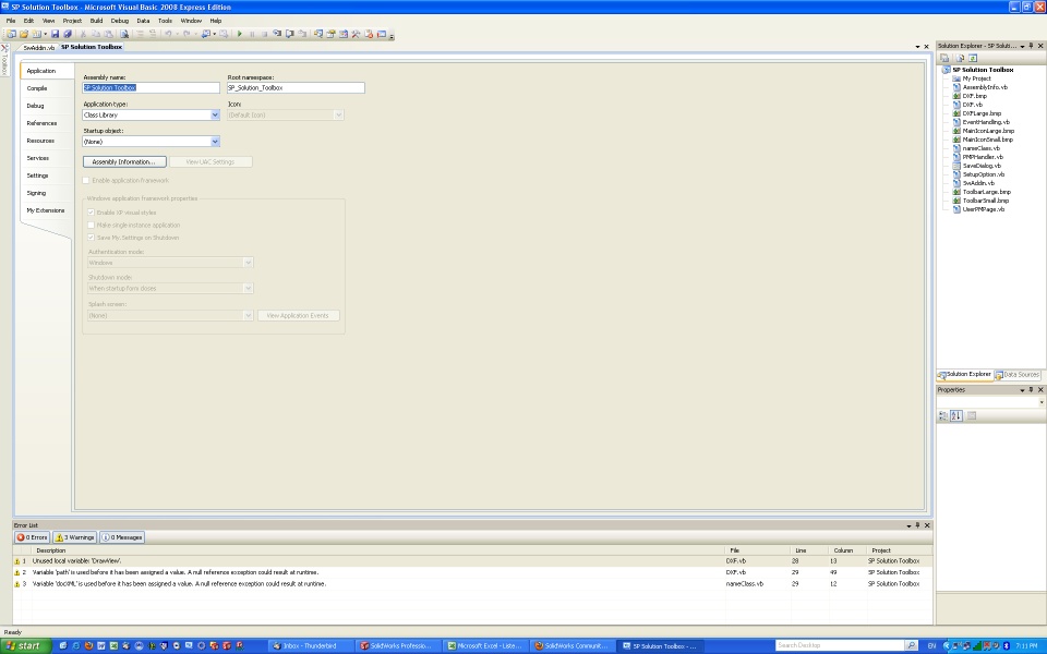

As I'm always inquisitive I installed the VS 2008 express edition - you can set Build properties and Build Events as you can do in VS 2008 full editions:
Build Properties:
Build Events:
Alex

IK
IK 2009-07-22
Is your program written in C# or VB? Build events are only in C#
SF
SF 2009-07-22
I don't have this in VB express you're doing C# not VB!
