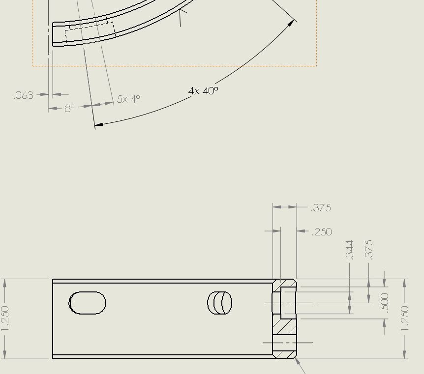

I 'm looking for an easier was to model this slot.
First I tried a sweep cut “T” shape as shown in the cross section.  Then I added fillets.  I wasn’t sure it was accurate and I wanted to use the sketch geometry on the drawing to assist in dimensioning the part.
I then tried a solid body sweep cut over the 4 degrees.  The problem here is that I had to do it with a .344 dia cutter and then again with a .500 dia cutter.
I tried to use a “T” shapped cutter but I kept getting a error saying something about a convex body or a revolved body.  I was using a revolve body to make the cutting tool.
Can I do this with 1 cutting body?

Is the bottom of the counterbore supposed to be a planar face or is it supposed to be a curved face?
(Sweep solid cut (on arc) will not result in a planar face.)
TS
TS 2014-03-06
It should be flat towards the ends and curved in the middle.  The Solid sweep should do better.  Another altrernative is to add counterbored holes then sweep cut what's between them.

Tom,
No you wont be able to use a solid body such a a "T" cutter.
It will only solid cut if the body is a convex shape.  That is a rod or a cone
You may want to try the Wrap feature - Deboss
