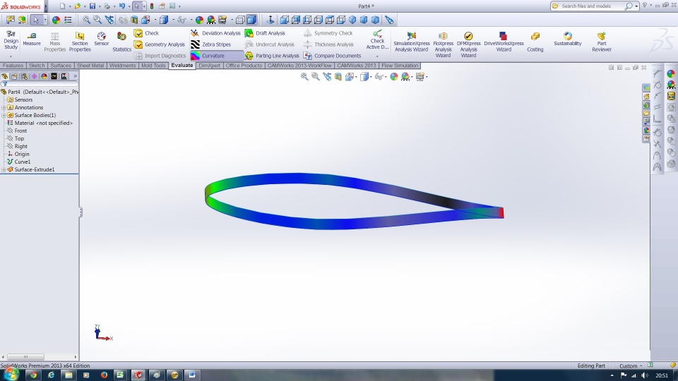

solid boss and surface extrude
hello guys , I could really do with help here .. I am an aerospace engineering student and currently am working on wing design project .. and i found out when I extrude a particular aerofoil using solid extrude (extrude boss/base) the model does not follow the curve as good as a surface extrude, surface extrudes are better to follow my aerofoil curve  is there a reason why this happens? .. do solid boss follow different mathematical method than surface extrude ? what kind of methods used in solidworks ? ..

JM 2015-01-21 Best Answer
Look at sweeps and lofts to achieve the curvature you're looking for when working with solids.
RS
RS 2015-01-21
Could just be graphic resolution.
