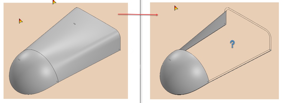

I'm not in front of my pc. But according to your video, if you right click Loft5 and select Change Transparency it'll be back.

Okay now I can remember a YT video. It is said that group of surfaces formed a solid. Surface extrude gives you only one surface at a time whereas solid extrude gives you many surfaces at a time.

Knitting takes care of the small gaps.

Loft surface then turn into solid gives correct result. I do not know why.

Maybe it's having hard time merging

Either you have a surface (or 2) set to transparent or you are having a graphics card driver issue.
