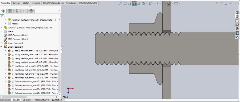

I used the "Smart fasteners" feature to get all fasteners in place and saving much time.
I started a simulation analysis but an error message appeared saying that i have so many components interferences.
The interference detection results saying that all my bolts and nuts made automatically with the "Smart fasteners" feature are interferenced..
The picture below will explain more about the interference problem :
i tried to mate the bolt with the nut using the mechanical mate "Screw" but it doesn't give me the possibility to select the thread schematic of the bolt.

Hi, you need to think about your objectives for the Simulation. Running an analysis with highly detailed fasteners (even if you solve the interference) will be very slow. Also be aware even those threads are representations only as they are not helical based. The screw mate depends on the start position of the bolt as it attempts to nest together the teeth- so this is typically done by eye. SolidWorks Simulation allows you to use bolt connectors to represent the effects of bolts (material, diameters, pre-loads) and these are better for quicker solve times. The only reason to really have bolts in the simulation is if the specific reason for the analysis is to predict bolt failure, or the effect they have on the fixing points.

Thank you Mr Adam for the explaination, its true that i always used to run the analysis  with all the details in order to simulate the behavior of the design in the real world. I will consider ignoring theses interferences to run the analysis.

i'm trying to ignore all the interferences to run the analysis but the simulation always fails ,, any idea how to ignore theses interferencens ?

So there is a couple of ways to approach this- you can define a local contact set for interfering faces and define them as shrink fit, but since you have the threads modelled you have to pick an awful lot of faces. What i would do is simply the holes and bolts so there are simply cylinders at the desired diameters. either have both diameters the same so you get a perfect fit, and that way you can define contact sets for no penetration, or make the diameter of the bolt bigger than the hole and define the shrink fit contact. see this blog
SOLIDWORKS SIMULATION TECH TIP: Shrink Fits and Press Fits
If the bolts are not important to the overall objective of the study, then use connectors but again simplify the hole to remove the thread and suppress the bolts from the study. See this help page
2017 SOLIDWORKS Help - Bolt Connectors
