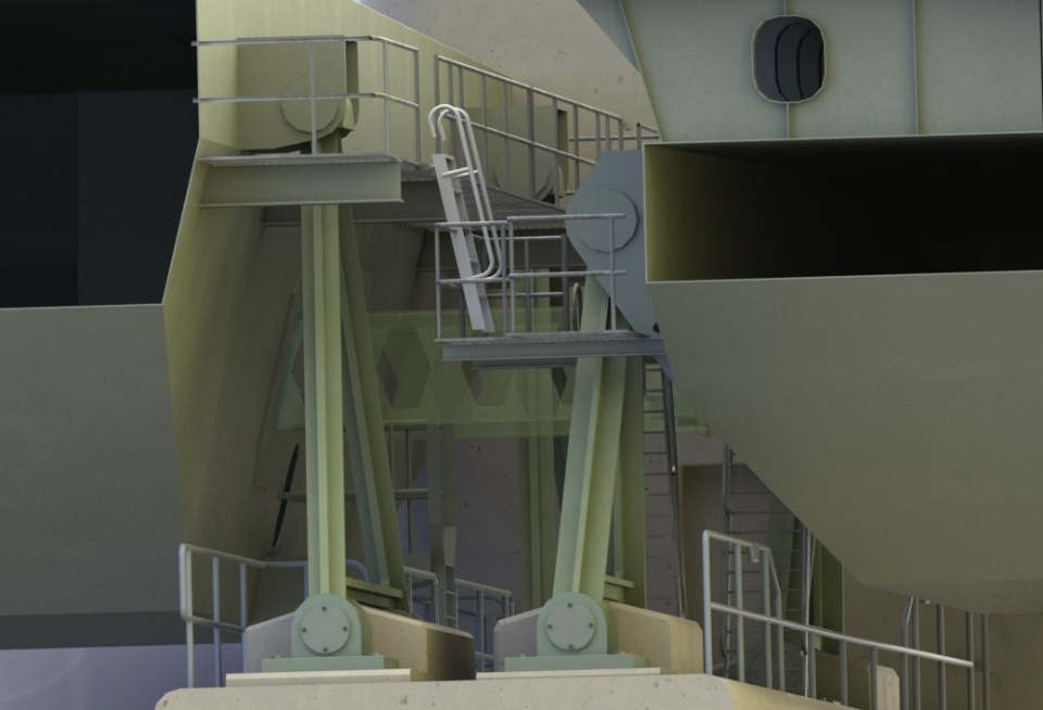

Can anyone advise me on how to handle large assemblies in terms of memory and speed. We design large bridges and have many parts and sub-assemblies within our master assembly. Can anyone give the best advice in how to control, produce assemblies of this nature please?
Nige.
