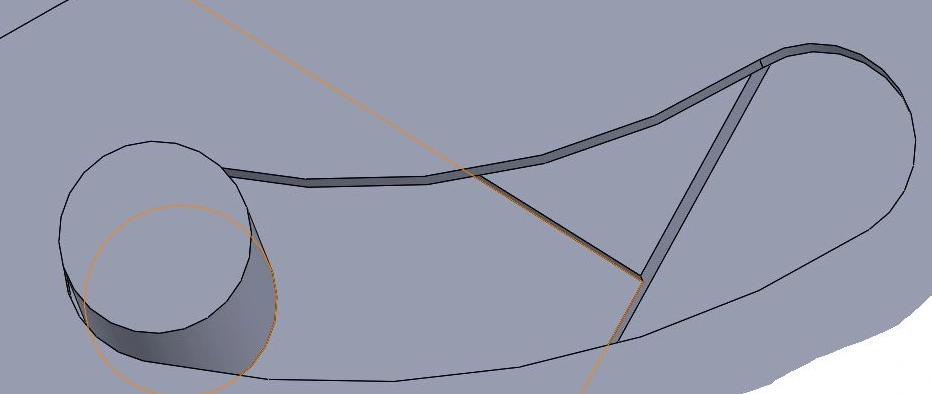

I am trying to make a motion analysis in SolidWorks. I have a slot mate which is not supported in the Motion Analysis, but I don't know how to substitute it. I have checked online but I haven't found any video or explanation on how to proceed with curved slots.

Hello. I think the quickest way to account for the slot is to define contact between the cylindrical face and the slot face (see drawing). Of course, I don't know the entire structure and I don't know how the motors/forces are defined, but when a collision is about to occur, the mechanism will stop.

I tried that but I haven't managed to make it work properly. The cylindrical part is actually the fixed one and the one moving is the slot. Could it be because of that?
I am trying to replace the slot mate with a path mate. The path mate seems to work quite well, but for some reason it does not take into account the ends of the path. It follows the trajectory, but it keeps going beyond the end of the path, as you can see in the pictures below (point of path = blue, trajectory = pink).
Do you have any idea why this might be happening?

Your method is also OK. Then try shorter the path by the cylinder diameter (the drawing shows it extended by that length). Let me know if that helps.
