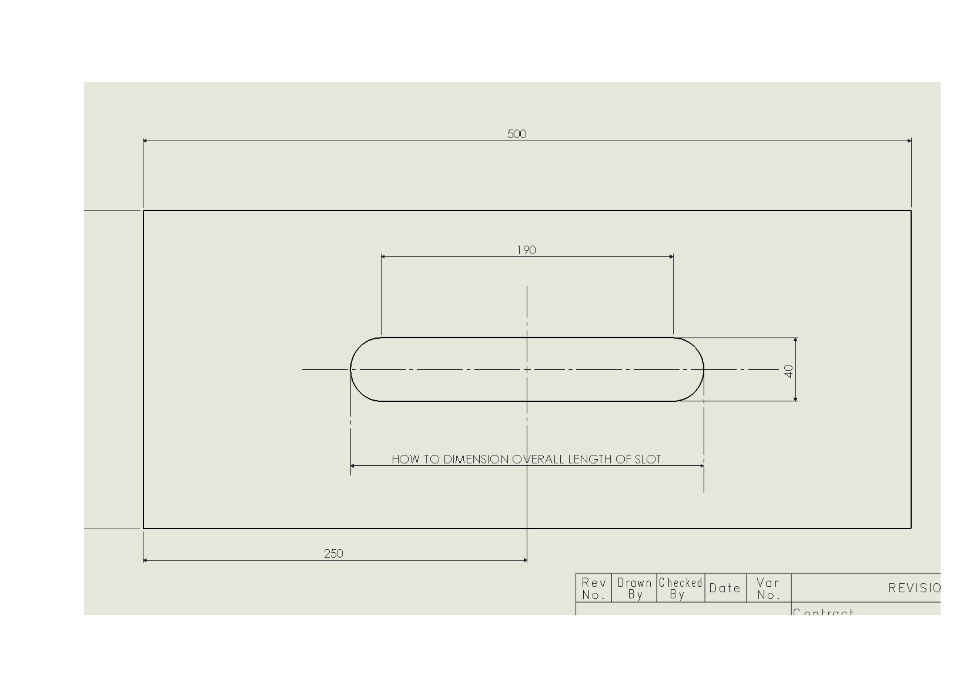

slot dimensions
Hi
I cannot for the life of me remember how to do this.
On the attached PDF file I want to dimension the from end to end to give an overall length.
However i cannot pick the ends of the semi circles.
What do I need to do to allow me to dimension this slot, what setting do I need to re-set.
Thanks
Mark

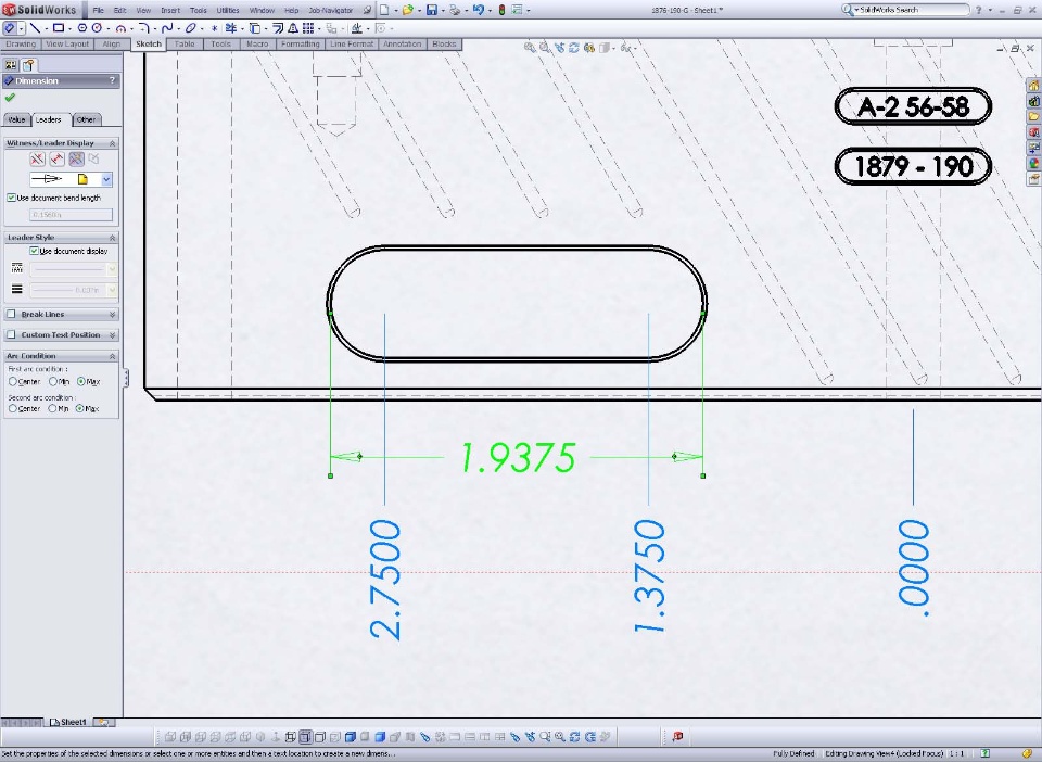

When dimensioning the arcs, pick the 'outermost' part of them while holding the shift key, this will place the dimension as you need.  Or you can dimension center to center, and in the dimension propery manager, set the arc coniditions to maximum.

A third way is to pick the arcs near their tangents, the dimension will go to the arc centers, afterwards, you can grab the dimension leaders and drag them to the arc tangents.

Another way is click on your dimension then top right corner will show leaders
and give you some options for min. max or center dimensions.
