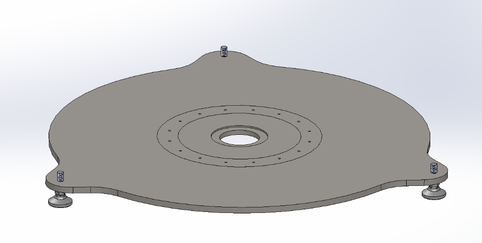

Hi I am a noob to simulation.  I am trying to run a simulation on the turntable base shown in the picture.
I have a 6000N force pressing down on the ring area (where the bolt holes are) and then the feet are sitting on a hard floor.  The foot pads swivel on ball joints in reality, but in the model there are just solid blocks.

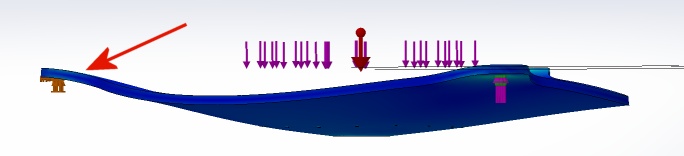

I set up a simulation for the plate part, where I replaced the bolt holes with merely a 0.001 deep x 0.5" diameter recess. I set those faces as "sliding" connections and got this:
This is not right because the edge tab appears to be fixed from rotating.  In reality the plate will curve like a bowl, it will not curve down again at the edge tab.
How would I set the foot connections as a sliding/pin connection?  In other words, make the feet be fixed in a horizontal plane but leave rotation and sliding in that plane unconstrained.

Slider constraints don't allow out of plane motion as far as I know.  Try putting the constraint on the bolt circle and your total force on the three 'leg' pads.

The issue is not that I'm getting out-of-plane motion. The problem is that these "rollers" are fixing the rotation as well.  I drew a sketch:
I want the unconstrained version.
I tried your idea to swap the constraint and the force, and that worked!!

That was my point.  With roller-slider you will NOT get any rotation or out-of-plane motion so it can instill additional localized stresses/deflections.
