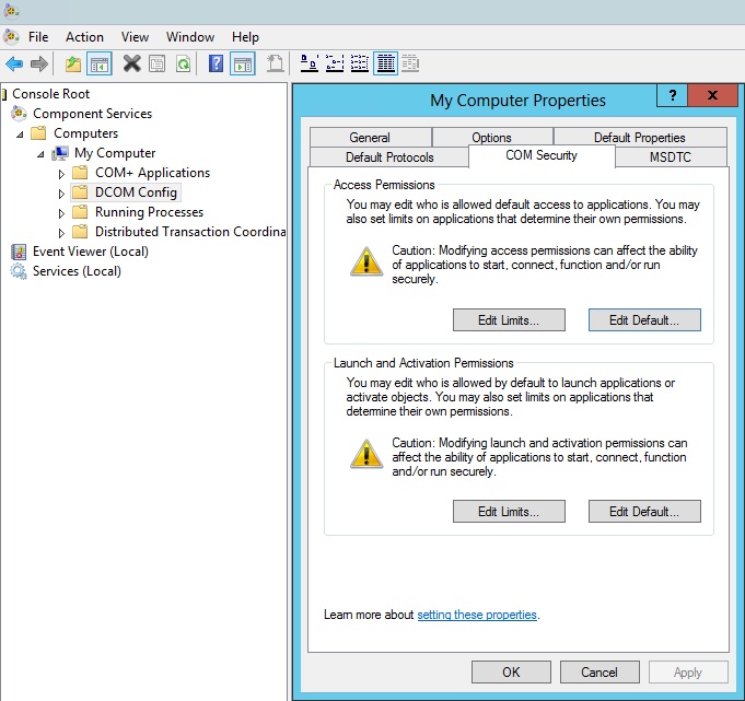

  • DCOM security privileges - it was mentioned that the user account IIS is using to run the service does not have access privileges to the DCOM objects. I went into Component Services->My Computer and modified both the global default security as well as the individual DCOM object's security. I have additionally tried running the IIS service under different user accounts (\\Administrator, \\Administrator, ApplicationPoolIdentity, NetworkService), each time ensuring the respective account had correct DCOM privileges, all without success.

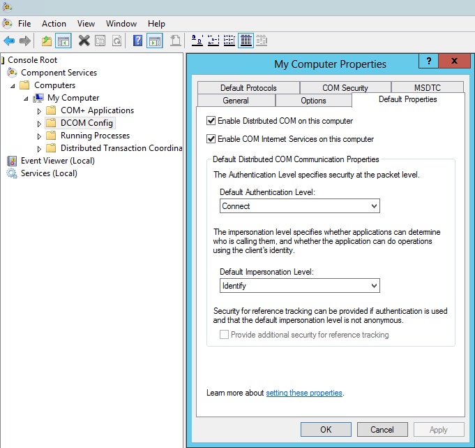

  • COM internet services - I had read that it could be related to COM internet services (found this one when searching more broadly). As such I tested this by enabling COM internet services. Still had no success.

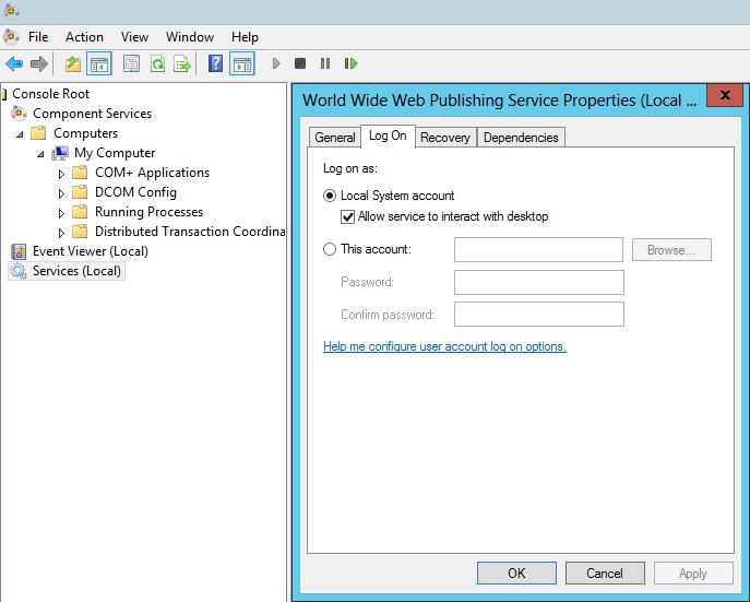

  • Allow service account to interact with desktop - I read that allowing the IIS service to interact with desktop could resolve my problem. As such I went to the IIS service Log On properties and allowed it to interact with desktop; still no success.

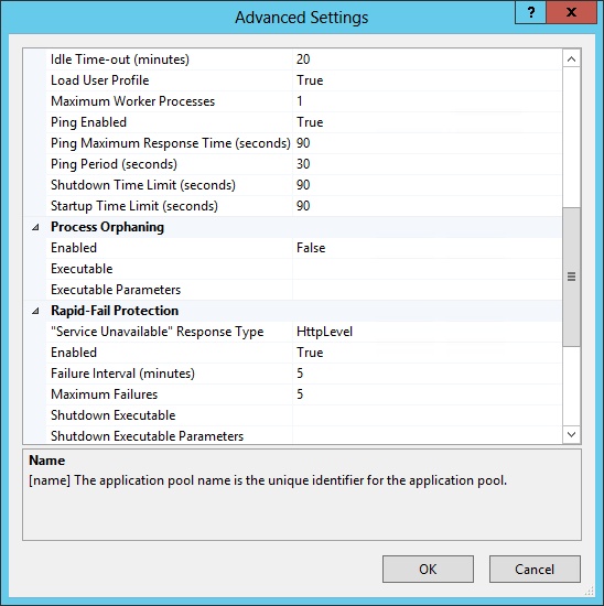

  • Load user profile - I read that SolidWorks requires a user profile to exist for it to launch correctly. As such, I went to the service application pool's settings and enabled Load User Profile.

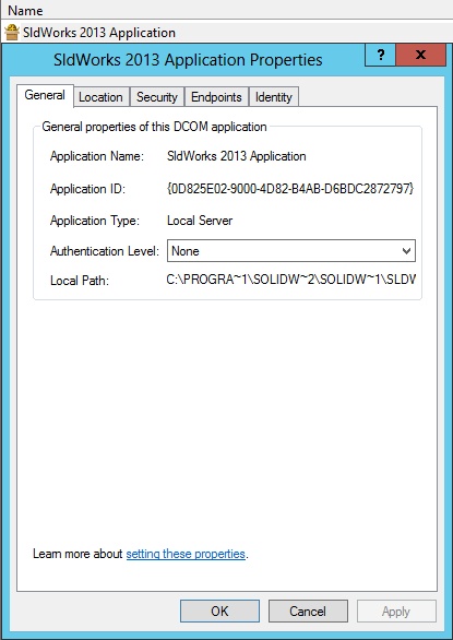

I am trying to narrow the scope of the problem... I went into the component services and modified the security for SldWorks 2013 Application - I set the authentication level to None to try and remove DCOM security from one of the possible causes. After setting the security to None I still receive the same issue.

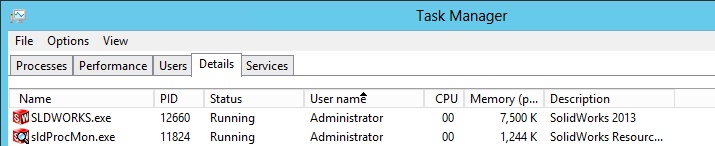

A little more information... I've discovered that the SLDWORKS.exe process is actually being executed for the duration of time that the service hangs on the SldWorks object instantiation. After the DCOM timeout period elapses and the exeception is thrown, this SLDWORKS.exe process then ends. Thanks again to anyone that can provide some guidance or troubleshooting ideas that I haven't yet tried.
