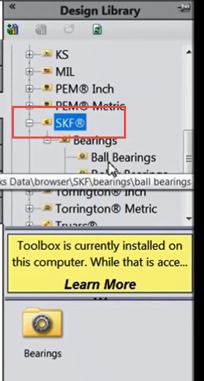

SKF folder
This is YouTube video. I couldn’t find SKF folder in my Design Library. Has it have any different name in newer version? I use 2016-2017 student edition.

See if you can locate the SKF folder in the SW Data folder
comment imagecomment image

Yes, I can locate the SKF folder in the SW Data folder.

Even without using the Toolbox, you should be able to use the Part file from this folder.

Is it possible to export it to Design Library?
AR
AR 2016-12-20
You can add the SKF folder from here
