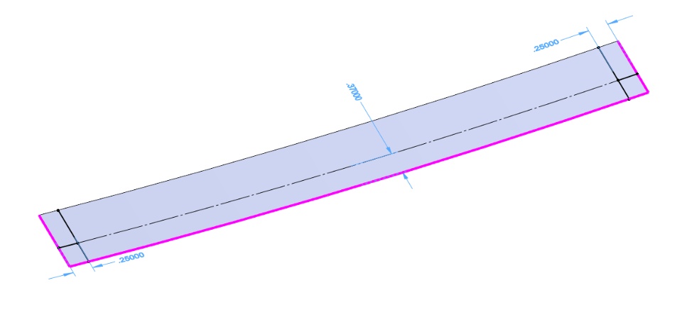

   I'm having difficulties with using IModelDocExtension::SketchOffsetOnSurface. The macro that I'm working on (VBA) is using PMP's to store user selections for (1) Face and (3) Edges. I'm currently using the PMP to:
  • Get Face from PMP SelectionBox.
    • Create Offset Surface from said Face.
    • Isolate Surface.
  • Get Edges (qty: 3) from PMP SelectionBoxes (qty: 3) from isolated surface.
    • Get pointer and execute SketchOffsetOnSurface/GeodesicSketchOffset Method.
  • After Offset on Surface has completed, get the sketch segments. (CAN'T select segments).
    • Trim corners (can't do this until I manage to get the segments created).
The depiction above shows post-trim, but shows the edges offset, like I'm working with.
So - I am able to recall & select the required Edges on the offset surface - no issues there now. I'm only able to successfully offset all of the edges about, say, half of the time. All of the surfaces I'm testing have four outer edges, roughly perpendicular, and have minimal curvature to them. I don't this this is a geometric condition issue - as I can successfully complete the offset condition manually.
