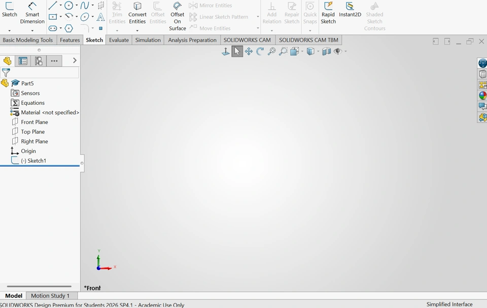

I'm a student using SolidWorks 2026. My sketches are hidden and I can't get them to display.
After I exit a sketch, it disappears from the graphics area even though it still shows in the FeatureManager tree.
What I've already tried:
  • Right-clicking the sketch in the FeatureManager tree and selecting Show
  • Checking View > Hide/Show > Sketches to confirm sketch display is on
  • restarting software
  • making a new sketch
Any ideas on what to check next? Thanks in advance!

The next thing that I would check on is the Video Card driver.  If you have one for 2026 look at getting the one for 2025 version of solidworks because if you have the student version you are essentially working with 2025 sp 5 or whatever the latest service pack that was.
KM
KM 2026-10-07
If enabled, try disabling enhanced graphics performance in options>system>performance (scroll to bottom).
This can cause a lot of graphical issues
JM
JM 2026-10-07
What are your computer specs?  To see if it is a graphics issue, go to your Solidworks system options, Performance and choose the "Use software openGL".    You can only check this if you have no files open.   Then try again, if the problem goes away you have a definite graphics/card issue.   Note that running in this mode is a big performance hit as Solidworks is doing the graphical processing instead of your video card.
