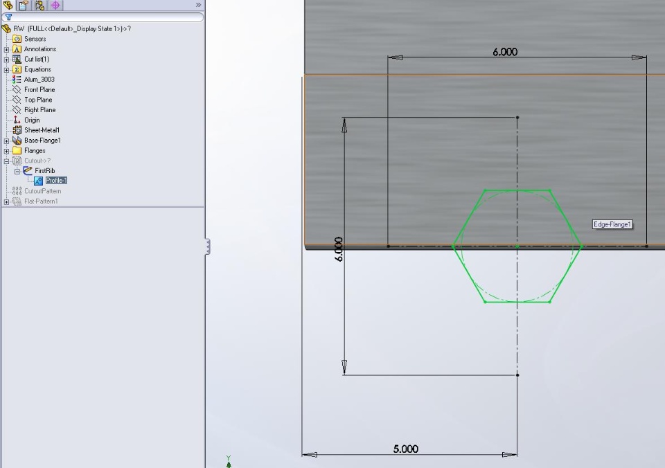

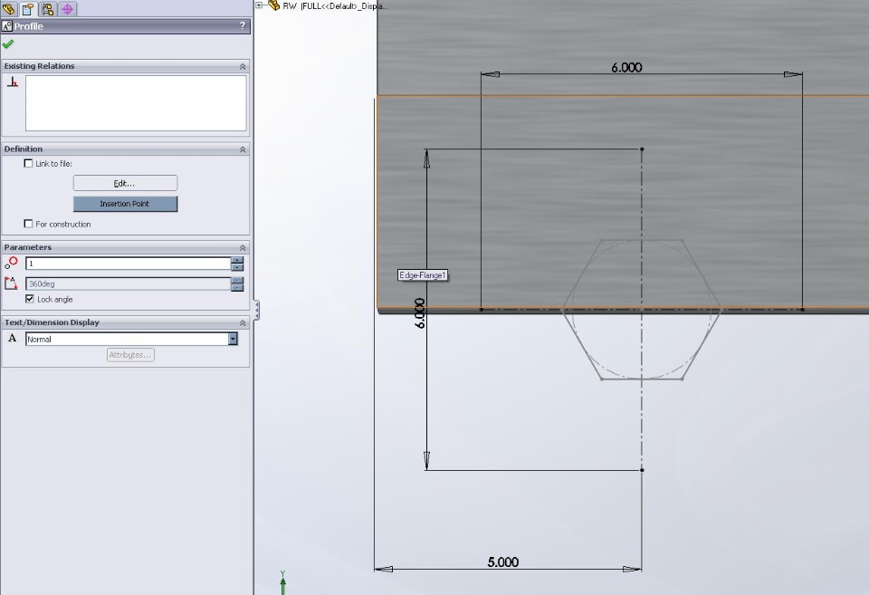

I'm trying to set LinkToFile property of SketchBlockDefinition to False, and I keep failing.
Is there a particular order this need to be done?
I can manage to enable the link when disabled, but can't disable it when enabled. Is this a glitch?
What am I doing wrong?
Also, another thing I noticed was, when a block is linked, if any relations are added between the sketch and the insertion / any gemotry of the block, they get lost after exiting the sketch for some reason....is this intended behavior? This is why I want to disable the link, since, when the block is unlinked, the relations seem to be kept.
To produce the problem, just create a sketch named "FirstRib" and instert a block into it, and name it "Profile" (whcih, in the end should be profile instance 1 - "Profile-1").
Below are some snap-shots, and a sample code...to reproduce the problem.
Thanks in advance
