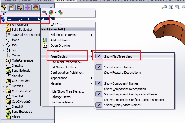

Right click on top of feature tree and set Show Tree as flat. Only available in part files, this option set to show features in the order they were created, instead of hierarchically.
I reread your post and sure this is not what is there in CATIA but might be somehow helpful.
