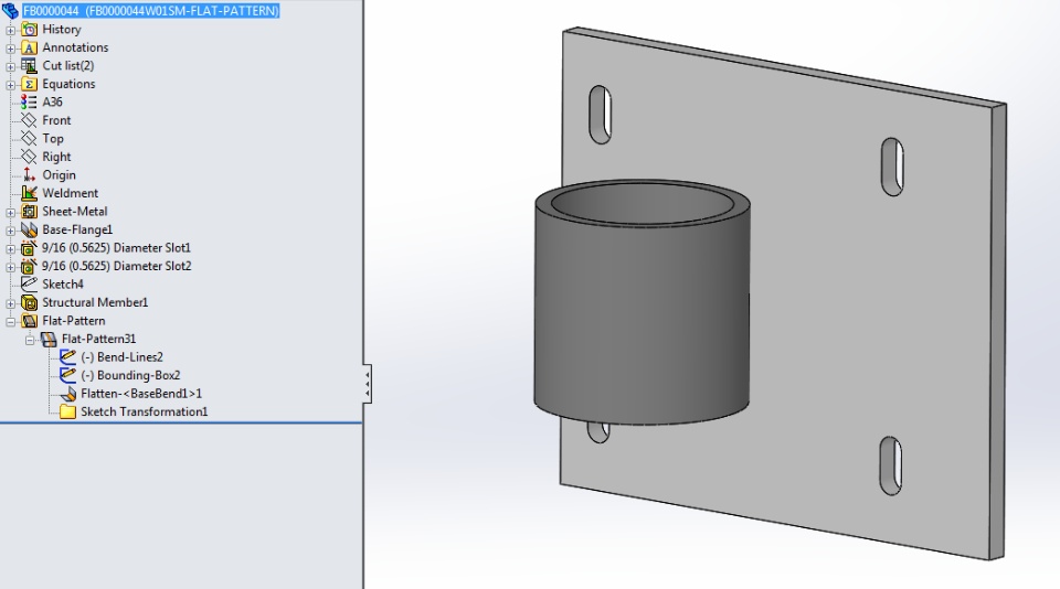

What does it mean when there is a "sketch transformation" folder (that is not expandable) under my flat pattern? If I ctrl-Q in the part it will go away, and so will the pipe (like it should). However, after saving my drawing with the correct flat pattern, if I reopen it, the flat pattern on my dwg is not flat. If I go to the flat pattern config, the "sketch transformation" folder is back. Is this what is causing my flat pattern errors?

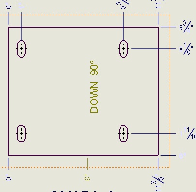

Here is a part giving me issues. Go to the flat pattern config and then expand the flat pattern in the feature tree and you will see the "sketch transformation". If you ctrl-q it goes away, but in a dwg ctrl-q doesn't help. Will someone throw this on a dwg real quick and see if the flat pattern will hold after closing and reopening the dwg? It is going to VAR in the morning.

Alright, I'll troubleshoot.  Here's a map of my steps.  I tried it, saved your file locally, made a bare bones drawing with a flat pattern view, saved and closed everything.  Opened the drawing up again and the bend lines were gone.  In the drawing's feature tree I could see that evil sketch transformation folder.  I opened the part,
Ctrl+Q-ed it, looked back at the drawing & the bend lines & notes had reappeared.

Observation - I just had a drawing cross my desk that the bend lines (single line in this case) did not dissapear with the sketch transformation folder present.  I took the same approach as we have been taking, save & close my drawing, open it again and in this case the lines are there.  I still see the sketch transformation folder in the drawing's feature tree.  I open the part and the folder is in that feature tree and CtrlQ still removes it.

I spoke to VAR and this what he said:
"It appears to be a bug when using the model view feature.  If I create the flat pattern via the view pallet it does not create the sketch transformations folder and works as expected.
I am on SP2 and am going to upgrade to SP3 this morning and will see if that has any effect.  "
He reported back that he was unable to reproduce it in SP3. The only problem with the view pallette is it doesn't work with multibodies. We are upgrading today (hopefully) and I will let you know if it is fixed.

This appears to be a known bug, as I see several unaddressed SPR's for it. It appears to be an issue with the items in the Flat-Pattern folder becoming suppressed or unsuppressed during the Check-in process. Below is a solution to the problem that I discovered. Please note that I am using SolidWorks 2014 and EPDM 2015.
  • Check out the drawing and the model. Open both files.
  • Activate the model window.
  • Activate the DEFAULT configuration, if it is not already active.
  • Click the plus sign next to the Flat-Pattern folder. Click the next to the Flat-Pattern feature.
  • Make sure that both the Bend-Lines and the Bounding-Box sketches are suppressed.
  • Suppress all of the Flatten features. This step is critical.
  • Activate the FLAT-PATTERN configuration.
  • Open the Flat-Pattern folder and feature by click the (+).
  • Unsuppress all of the Flatten features. Make sure that the Bend-Lines and Bounding-Box sketches are unsuppressed and not hidden.
  • Reactivate the DEFAULT configuration and verify that everything in the Flat-Pattern folder is suppressed.
  • Hit Ctrl+Q to rebuild, click the Trimetric view button, Save, and check in both files.
  • The next time you open the drawing file, the bend lines will be there.
    • Note: If you open the file and the bend lines are not there, then it is likely something went wrong in the process. While performing this exercise, it is worth toggling back and forth between the flat configuration and the default configuration, each time validating that the items listed in the Flat-Pattern folder are unsuppressed or suppressed in their respective configurations.
