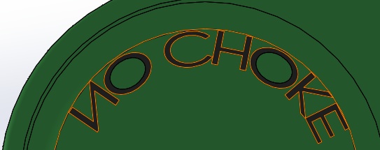

Why is my text sketch backwards on this curve? The letter N is backwards. Anyone know how to fix this?
That's really interesting. I notice if you put the text on top of the arc it displays correctly. An obvious bug.
Great it's not just me then. lol thanks
It appears that changing the side of the arc mirrors the text. You can see this in the K & the E also.
It is probably all the letters. I just used a different arc to the outside and fixed it. Thanks for your help
