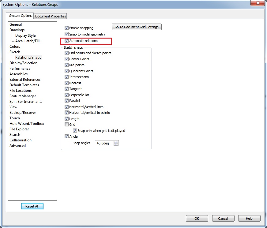

You can turn off automatic relations.  If you do this they will only be created manually so if you chose to never create one then there would never be a relation icon to pop up.  Might be hard to get fully defined sketches though.

Ryan, he isnt concerned with the auto relations(which can be temporarily disabled during sketches by holding CTRL), but rather the small relation icons that pop up when you select your sketch lines.  Like the small boxes that tell you if your line is horizontal, or coincident and so on.
