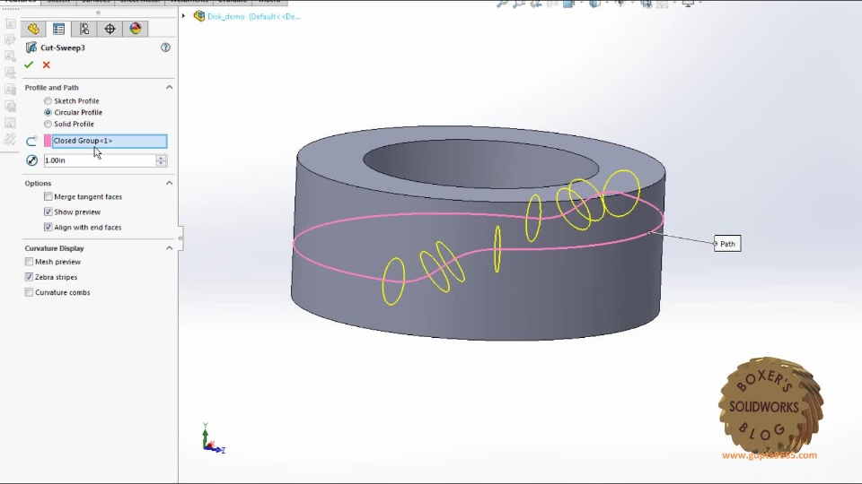

Hi Everyone,
I have projected the following curve on a cylinder. However, I need the features to be symmetrical and the projection is not.
Any idea how to properly project it?
Furthermore, I will need to cut  this part in 2 along the projected curve.
Any help is appreciated.

Here is what I would do.
2017-08-20
,Hi David
:In order to get a symmetrical projection you should draw a symmetrical sketch and then make a split line on the external surface of the ring
      (The line that used for the split line on the external surface of the cylinder)
    (the result of the swept cat)
In order to make an even parts that cutted in the middle of the swept cut, you can create a surface by converting the split line enteties in 2 seperate 3D sketches,  create a boundery surface and then split it by the created surface.
Example:
     (Assembly between splitted the parts-> Exploaded View)
Hope it will help you,
Moshe Y.

The first thing that I would start with would be to fully define your curve sketch - if you make it fully symmetrical, it should transfer through to groove in the part.
One of my recommendations would be to define the overall length of the curve sketch as pi*D1@Sketch2 -> this will make it always equal to the circumference of the initial extrude.

David,
To split your part you can use the original sketch from your projected curve, although you cannot use an absorbed sketch for the Split feature. Edit the original sketch, select the geometry & create new sketch from selection, exit sketch (do not cancel out). You can then select the new sketch as the cut for the split feature.
