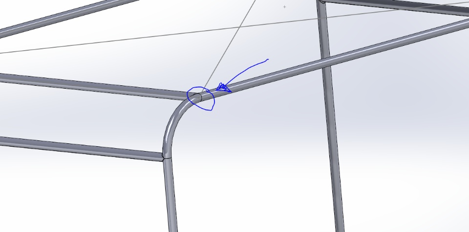

I am probably overlooking something extremely simple, but it has me stopped dead in my tracks. I'm trying to make a sketch plane perpendicular to a line, as if it was balancing on the line's endpoint.  For the life of me, I can't figure out how to do it.  Anybody have any helpful tips or tricks?  Or a brick to hit me in the head with for not being able to do something that's probably incredibly simple? I put a picture to help, though I'm not sure how helpful it will be.

Select the line and endpoint, then activate the Plane tool and the new plane will be automatically created.

select the line and the endpoint when defining the plane.

Thank you.  I didn't know there was a plane tool.  Worked perfectly!

Select the end point and the line then click Plane (just had to throw in the same response again).

I was recalling that if you select an edge, and then click the Sketch button, a plane will (usually) be created at the end closest to your selection point,  and the sketch opened on it.  Just two clicks, very convenient, most of the time.  But that only works for edges (solid or surface).  Try it with a sketch line and you end up editing the sketch.  Since you've got me thinking about it, I think it would be handy it the "make plane and open sketch on it" function worked with sketch segments too. Perhaps something like "alt+Sketch button" or maybe a dialog box with something like "Do you want to make a new sketch, or edit the selection?".
