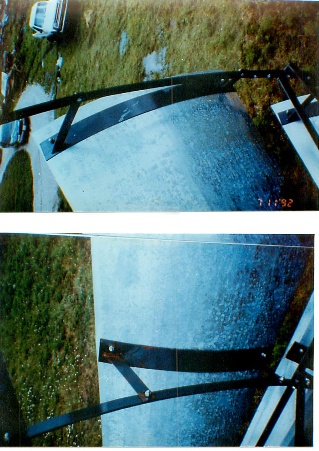

the "best" way will really depend on the shape you are looking to make. attach a picture or sketch if you can.
Here is the sketch. I need to create a bracket that will attach to this part (yellow part). I want the front of the bracket to have the same surface shape as the brace, thank you.
