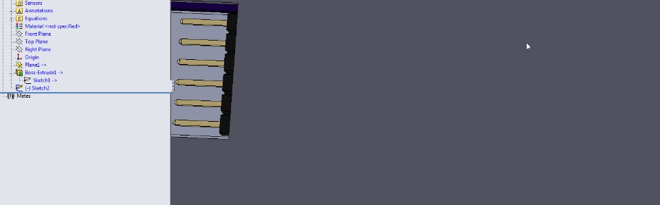

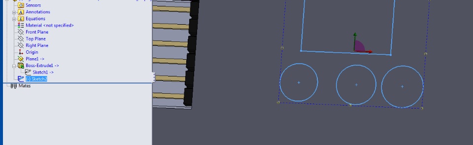

I am having problems with a sketch disappearing.  I have reset all preferneces to default and it is still not showing.  The sketch does show properly on the top face of an extrude when seltected, but disappears when no.
Any idea why it would not be showing up?

The sketch is not just blending into the background color?

I have seen this before, but it seems to be occurring more frequently now.  I did some more testing and it seems to be a problem mainly when viewing the part within an assembly.  When I initially open the part discretely the same problem occurs, but after moving things around a bit the sketch shows up.  Seems kind of random.
