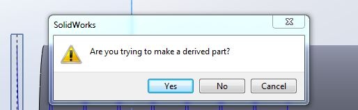

Is it possible to save a sketch as a libray feature and then be able to drag and drop that library feature sketch onto a sketch plane.
I tried and got this message
When I select "No" it just opens the sketch. So Im either going about this all wrong or it cannot be done

Colin, I don't think you will be able to use the library feature to drop a sketch on a part unless you were in an assembly. Otherwise you could save your sketch as a block, and then just insert the block on the plane you want.

Hello Colin....
I Drag and drop sketches from the design library all the time, esp. for thread profiles, as we always model the threads on our products:
Here's how I do it:
1) Create a library either in your network or desktop to save the sketches in
2) RMB on your design library in the right pane, and select "add existing folder". Navigate to the newly created folder.
3) Once your sketch is defined, then select the enities you want as a "drag & drop" item. RMB and select "Make Block". A block will be created with a default name. Right click on the block and rename if desired.
5) Re-select block, RMB, then select "Save Block"
6) Navigate to the directory you created in step 1, and save the block to that directory.
7) Refresh the Design Library, and you block will appear.
8) You must already be working in sketch mode to be able to drag and drop sketches, and have them orientate parrallel to the desired surface or work plane.
Hope this helps!
-Keith
