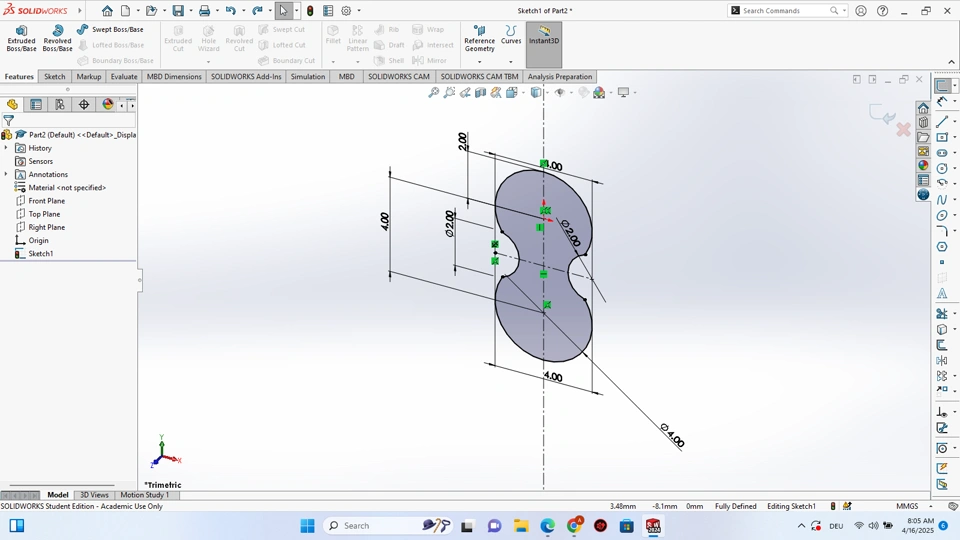

I try to generate a peanut like shape using revolved around the vertical central line shown in the sketch but I keep getting that error message ;Sketch is open, self intersecting, or intersects
any idea?
thank you!
Greetings
any idea?
thank you!
The sketch should be on one side (half way) then it will work out
I mean like this. then the vertical line should be a full line not construction. All the best as you enjoy and discover more with SolidWorks.
yes exactly , thank you very much
You should familiarize yourself with the "Check sketch for feature" tool. it will help you diagnose and fix sketch related issues. Repair sketch can also be helpful but a little flaky.
