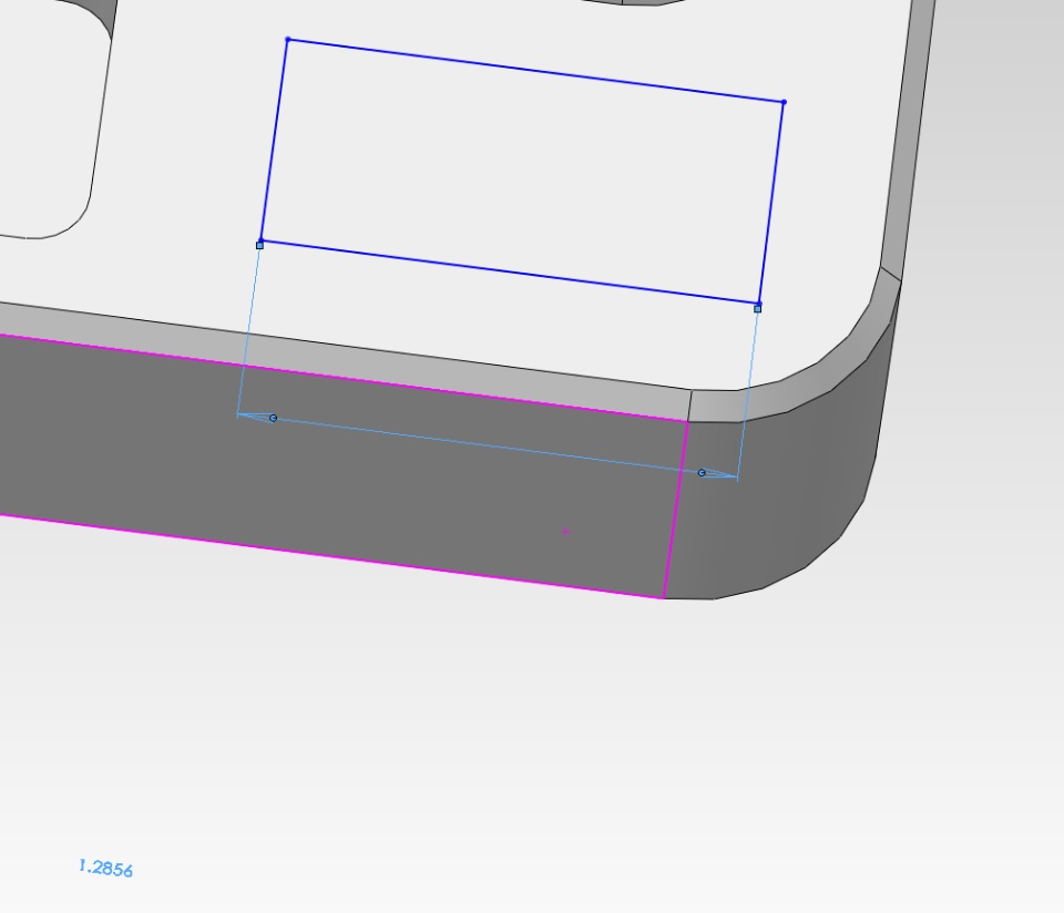

I'm having this problem in one of my parts. It's a bit hard to explain. Whenever I am sketching and I add dimensions, the dimension values don't stay on the same plane as the sketch when rotating/zooming/panning.
The first picture is just as I'm placing the dimension, as you can see something is already wrong. sometimes numerals are missing, sometimes they aren't.

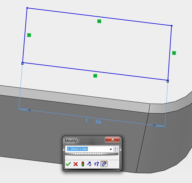

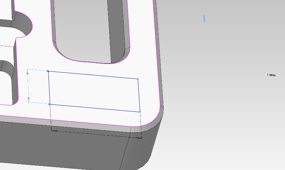

The second and third picture are when rotating the view, as you can see the values for the dimensions go off the sketch plane. Sometimes they snap back after I stop rotating, sometimes they stay on a different level or dissapear all together.
(here I am rotating the part toward me)
Look at the values in the top right corner of this picture.

We found the problem - it happens only when perspective view is on.
