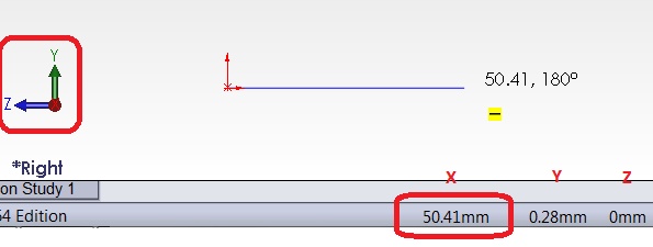

Maybe I've missed something really basic, but I always assumed that if you were in a sketch, you sketched according to the part coordinate system.  So if you are in the Right Plane and create a line from the origin immediately to the right, it should be going in the Z direction.  But its not.  Until you actually place the line, the system bar at the bottom says that you are going in the X direction.  See the attached picture to see what I mean.
Now what is really crazy is that once I place the line, and then select the end point, it then gives the coordinates with respect to the part.
Hope that makes sense.  Is this always the way it has been?

if you look at the Z the possitive direction is to the left or pointing to you!!!!!!
put it into an iso view when you draw the line makes it so much easier to understand..
yes it has always been this way..... look at the triad in iso pos Z points to the wall behind you

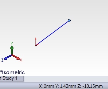

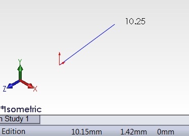

Attached are two pictures in Isometric view.  As you can see, the numbers in the status bar of "pre.png" (before I had placed the line) do not correspond to the standard order of X, followed by Y, followed by Z.  Then, once the line is placed and the point is selected ("post.png"), they do correspond to that order.
PRE
POST
Start a sketch on the Right Plane.  Do you not get the same result?
Keith

While sketching and pulling it is using the the plane for the X, Y of a 2D plane aka vertical, horizontal. then when you have stopped pulling and just click the end point it is in the default world view X,Y,Z until you start to pull which activates the sketch vetical and horizontal again.
makes sense to me
