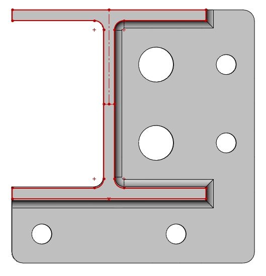

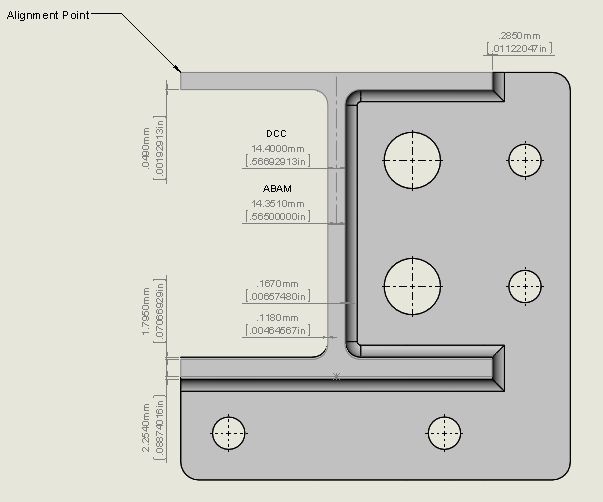

I have a part that I have superimposed a sketch over to illustrate a deviation in size.  In the part I can change the sketch color but when I make a drawing of it I cannot make it show up in color.  I’ve manually selected and changed the line color but it won’t change.  I’ve tried it both in HLR and Shaded with Edges to no avail.  Is there a way to do this?

David,
The sketch becomes inactive so you need to make sure it shows up under views that sketches are selected then select sketch inactive and change the color. Hope this helps.

Thanks Russell, worked like a charm.  The only way I can make the lines work like Glenn suggested was to activate the view (double click), select the sketch in the tree and then hit the convert entities to put the lines on the paper rather than on the part.  Then I could use the line format toolbar.  I guess I have another thing for my enhancement request list.

For what you're doing Russell's method is certainly better than mine, but I don't want you to think I gave you incorrect advice so I would like to clarify.  You don't have to activate the view first.  Find the sketch in the tree, RMB on it and choose Show.  That will make the sketch visible on the drawing.  Click on the individual lines in the drawing to highlight them and then you can change their color with the Line Format toolbar.  This will work particularly well if you only want to change the color of part of the sketch and not the whole thing.

The sketch is shown in the drawing (Sketch in Drawing.jpg) and I did select all of the lines and assign a color to them using the Line Format Toolbar but they still show up (print) as grey.  Am I missing something?
