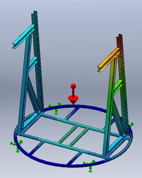

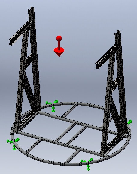

Hey Anthony,
Thanks for the response. I tried to do what you suggested but I was not able to get it to work. I removed all but three components: one ring weldment that is treated as a beam and two vertical weldments that I treat as solids. I am thinking that it is the means of connecting these together that is causing my problem. I tried to use the joints on the ring beam and bond them to the bottom surface of the vertical weldments. Is there a certain way that you are suppose to connect solids and beams together? Anyhoo, I performed a static analysis as you suggested and it deformed as expected, see attached pic. Thoughts?
