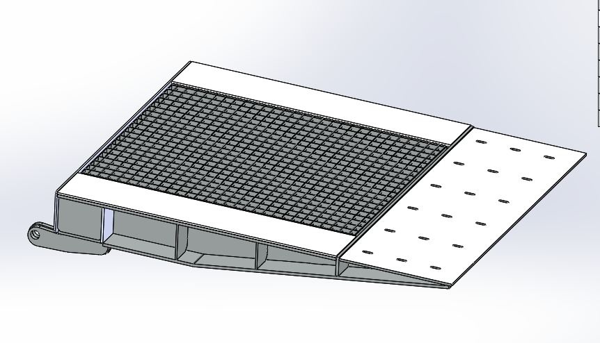

Dear All,
I have a question that can we use somehow simulation Xpress Wizard for weldment assembly by converting weldment into a single part.. and if its possible how can i convert the assembly to part to use it for xpress wizard??
Thnx
Yogesh

SF 2014-02-23 Best Answer
You could use the combine add function to convert to a single part
SF
SF 2014-02-23
But consider, that will be a hard part to mesh, the full sim tools have the idealizations and controls you need for weldments analysis
SF
SF 2014-02-23
Thanku for your reply...but I already tried it to convert it as a part..
1) First I save as assembly as part  than i selected all the bodies and right click it dont give me option to combine.
2) Than i save as assembly as step file and tried but again the same thing..
My boss dont want to spend on SW Premium so I need it somehow to solve with xpress.
If you know more please let me know..
Thnx
Yogesh
SF
SF 2014-02-23
Insert > feature > combine > add
For a proper analysis, consider outsourcing. But the cost of solidworks prem will be pretty comparable.
