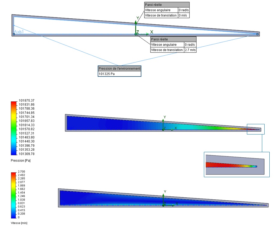

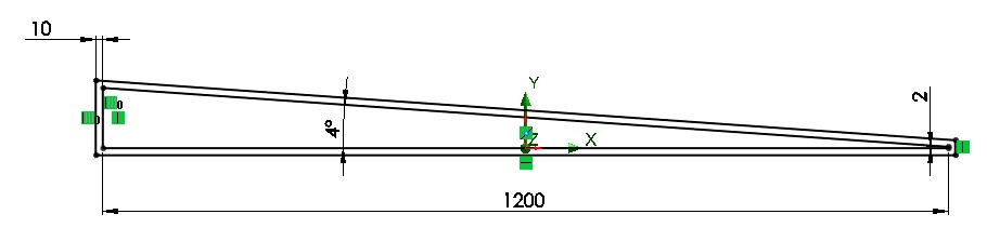

I try to simulate only the water under a skimboard (surfboard).
I put an initial velocity for the axis x = 2.7m/s
I put a real wall with a velocity of 2.7m/s
I put a real wall under the skimboard with a velocity of 0m/s
And I select the two surfaces for the environment pressure.
The picture with the pressure is true.
But for the picture of the velocity there is a mistake. I don't known where?
Can someone help me, please. Thank you
SolidworksFlow Simulation
Answers 1
SF
SF 2011-10-06 Best Answer
It looks like you need more "open space" downstream of the skimboard. Also, why not simulate in 3D? It would be interesting to see where the transition from laminar to turbulent flow occurs, if it does at all. Hope this helps!
