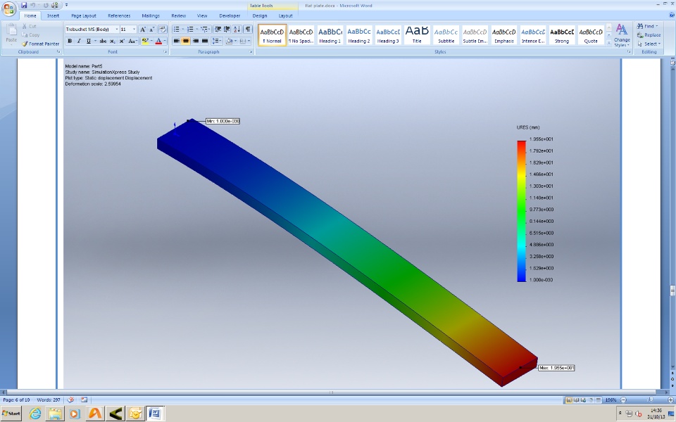

When running a simulation is there a way to have the results shown in (mm) rather than as a scentific notation.
I.E. 19.55mm rather than 1.955e+001.
Thanks
Mark (SolidWorks 2014)

If you double click the results chart, the fmt comes up with chart options. Or right click the chart, and select chart options from the rmb menu.
Right click on the results icon and choose Chart Options.
Change from Scientific to Floating

Thanks for that. Problem solved.
