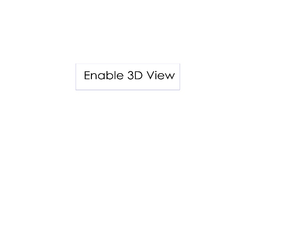

I have attached a 3D PDF of the model, made the CAN and Heat Sink transparent, removed one side and as you can tell, it is very basic in design.
