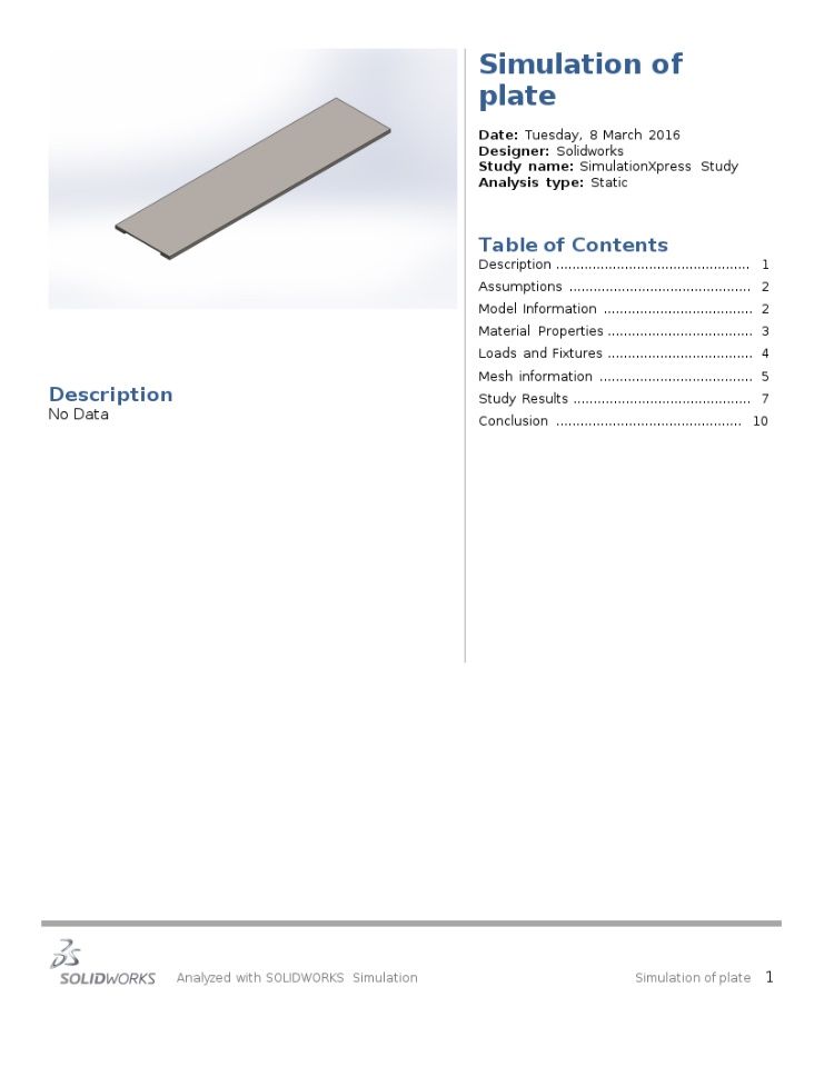

I am working on a case study and I am required to design machine elements with a maximum displacement of 1/1000.
As a "proof of concept" i have taken a sheet metal and calculated the maximum expected force on its surface.
I need to determine the maximum span between beam members for a given sheet metal.
I have chosen a 5mm cold rolled sheet metal:
  • 5mm thick
  • 1220mm wide
To determine the vertical deflection, I need to obtain first the Second moment of inertia, which is Ix = (1220 x 5^3) / 12 = 12,708
To determinate now the deflection, I have used the following equation for equal distributed force:
y=(5 x F x L^3) / (384 x E x Ix) = (5 x 2.36kN x 200mm^3) / (384 x 200 x 12,708) = 0.097mm
To simulate the same I took SimulationXpress and created a part as described above and applied the same force to it.
However, when I create the report, the maximum displacement is not near the calculated value of 0.097mm, it is shown on page 7 with 0.021mm. I have attached the generated report for your reference.
Do you have any idea what I am missing?
Note: I am working with the current Student Edition.
Thank you, Frank

Can you show the dimensions of the model? Also, what is your source for the hand calc?

Thanks for your reply Mike,
The dimensions are 1220mm long and 300mm wide. The supporting beams are on the 300mm side.
Thickness is 5mm.

Both ends are effectively fixed in the simulation which will impart extra stiffness when compared to the simply supported assumption. Perhaps a better hand calculation to match the simulation would be to use a beam bending calculation for a beam fixed at both ends with uniform loading. The equation for maximum deflection in that case is ( F*L^3 ) / (384*E*I) or a factor of 5 less than the simply supported beam equation you posted.
That being said you should question which boundary condition is more representative of the real world application.

Hi Ryan,
That is the solution! Then I am wondering how am I able to simulate it in SLX? I am certain that both ends are not fixed and are like a rolling bearing.
