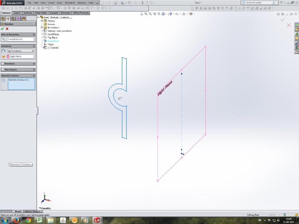

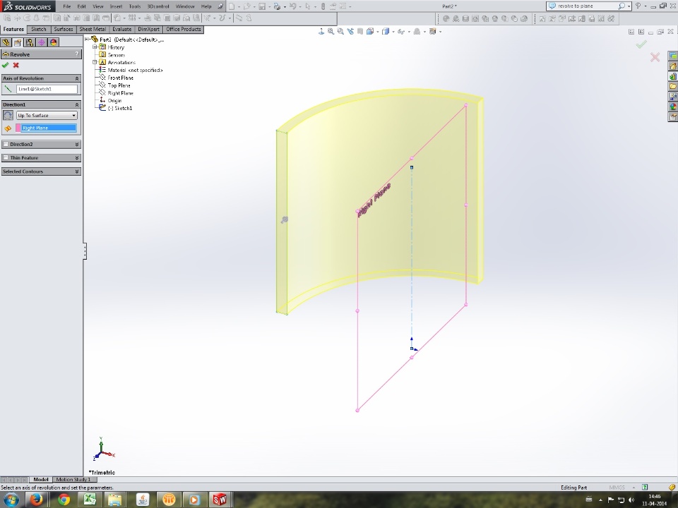

I need to have a sheet metal tube and want drive the seam location with planes. I have found that SW cannot make a revolve when you have a curve on the inner tube, when you select: "up to surface", this is done in normal 3d moddeling and not in sheet metal. I think it's a bug and needs to be resolved by Dassault. In the first picture you can see how it should work, second picture shows the problem.

Yep, you called it.
Get an SPR started with your VAR so we can get this fixed.
