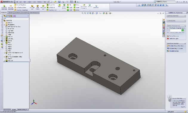

I was going to try to use a design table, but for some reason while following the tutorial, I could not select dimensions to load into the design table - so I figured fine - I'll do them all individual parts.  I did that.
Next comes detailing all of the near identical parts (with the exception of that tiny hole in the middle of the top edge moving).
Is there any way to reuse the drawing and just redirect which part it's looking at?  Solid Edge you could just edit links, Inventor you could just hide the original part for a little and then tell it to look for the new one, SolidWorks seems to not cooperate on either approach.
I have it to the point where I told it to look for the new part, and I can go into the drawing and right click - open the part file, but nothing shows up in the drawing except a rextangle with an x in it!
