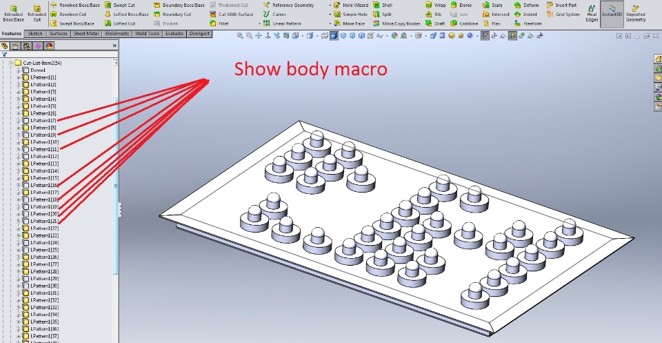

Show multibody
solidworks Show body macro
Show multibody macro
Would you do the macro
SolidworksApi macros

Try this macro:
<p>Dim swApp As SldWorks.SldWorks</p><p>Dim swPart As SldWorks.PartDoc </p><p></p><p>Sub main() </p><p></p><p>    Set swApp = Application.SldWorks</p><p>    </p><p>    Set swPart = swApp.ActiveDoc</p><p>    </p><p>    Dim vBodies As Variant</p><p>    vBodies = swPart.GetBodies2(swBodyType_e.swSolidBody, False)</p><p>    </p><p>    Dim i As Integer</p><p>    </p><p>    For i = 0 To UBound(vBodies)</p><p>        </p><p>        Dim swBody As SldWorks.Body2</p><p>        Set swBody = vBodies(i)</p><p>        swBody.HideBody False </p><p></p><p>    Next</p><p>    </p><p>End Sub</p>

thanks
