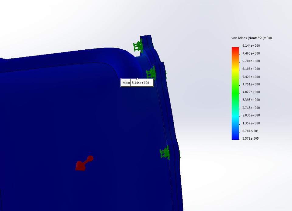

Hi, i did a static study and the results are shown in the figure i attached.
However i can't see the exact location of the maximum stress because it s below the surface (my model is hollow).
is there a way to make a cut plot, or hide other parts of the assemly so i can watch onto the location with maximum stress?
Thanks in advace
Theo

Hi Theo,
What you could do is use an iso clipping to show only areas above, below or between values that you define.
If you right click your stress plot and select iso clipping, you can then show only the material that is above the threshold.
Best,
Iain

you can explode all your parts in the assembly.
then load the stress plots, now you can see the area of the maximum stress.
if you want to know the value you can probe it.
