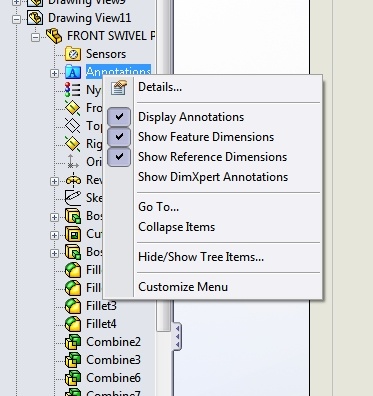

RC in the feature manager and select show annotations
Then hide the one you want.
comment imagecomment image

I am not sure what this is supposed to do, but it is already checked on this model view.
When I was running Pro-E, to add dimension to a view, you opened a show/hide window.  When you did this, all the dimension for that view would apear.  Then you could choose select to keep or select to remove and you selected the dims you wanted to keep or remove.  When you hit OK, the dims you wanted to keep were in only ones showing.  I want to do this in SW.  Can it be done?

Your screen shot is identical to mine.
